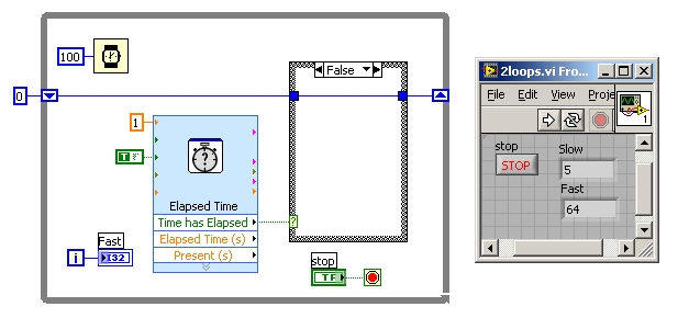

You can use an Elapsed Time Express VI inside the fast loop to see if it's time to execute the slow loop.  I took the liberty of not using a loop for your "event B" because it sounded like you just want to pace it with event A.  Put event B in the True case of the Case Structure. The producer/consumer design pattern is the way to go if you're developing a complex application. This'll do if your problem is relatively simple.

Thanks for the solution
I also found that passing data between parallel loops with local variable could do the trick
(5,200 Views)
