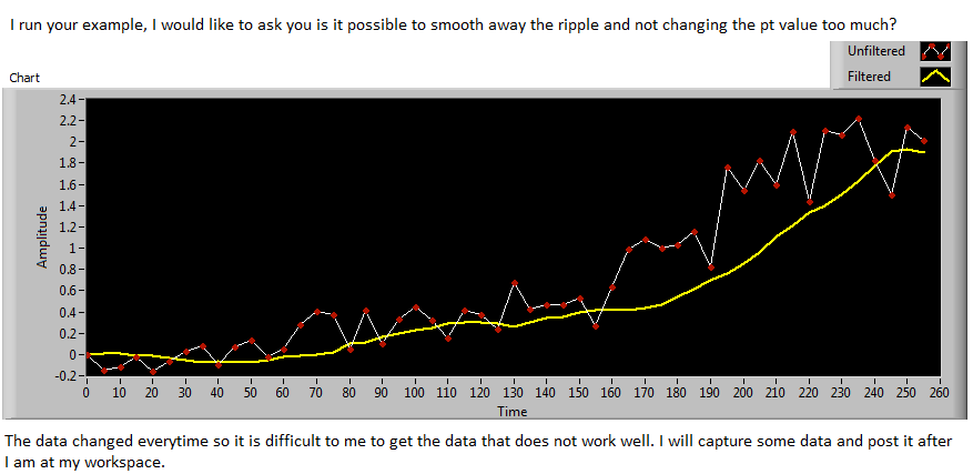

Hi Altenbach,
I am not sure why I am having this problem. You see in this image, the value is not even close. Is it normal, or perhaps this filter dosen't work for me?

Hi Altenbach,
I used your method in my code and run it. The image is what I get, in the graph there is only 6 pts. In the data I attached previously, there is 52 pts. The filtered data and unfiltered data differ alot.

You only show 6 points, not 52. You still did not tell me if you get a reasonable result by running my example with the default data that is already in it. I am trying to figure out if the algorithm or defaults have changed.
Would it be possible to attach the actual data (52 pts) that you think does not work well.

Hi Altenbach,
Message 17 of 20
(2,470 Views)

What is a "pt value"?
A point-by-point approach typically always lags a little bit, because it only has one-sided information and cannot predict points that haven't been measured yet.
