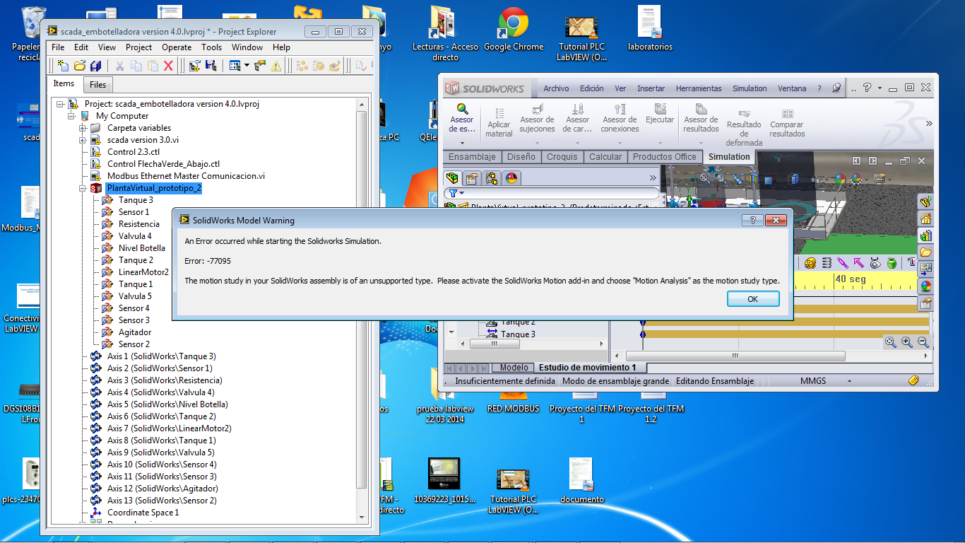

Hi AshT3T2T,
🙂 I'm glad that there are more people studying these software. I work during the last month with these programs successfully. But in the last week has also left me the error -70229. I am trying to solve the problem. My English is not good and I have difficulties. I hope to get to the solution today or tomorrow. I would like to share with you the progress and help each other.
Best regards
This has been another error found
