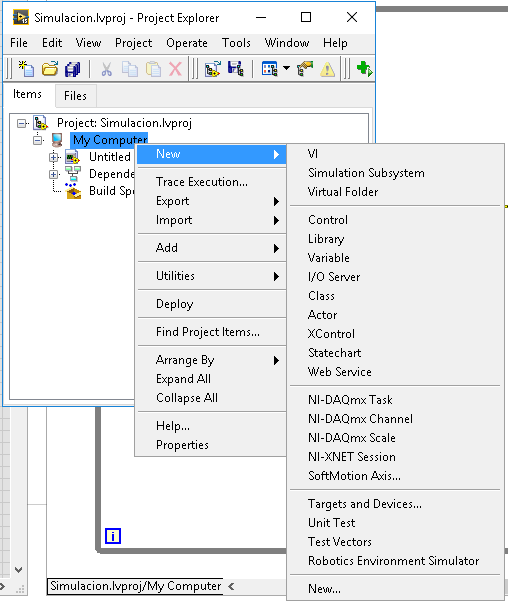

Actually i have been stuck for a couple of days seeking to synchronize solidworks with Labview using the soft motion module, unfortunately i couldn't see any rotary axis under the solidworks assembly in the project explorer window. well i found out that i need to synchronize solidworks with Labview but i didn't find any clue or icon to click on.
Please check the screen captures below.
Looking forward for your kindly helps.

I have labview 2015 32 bits, I installed Softmotion 2015 but not show the option "Solidworks assembly"
I don´t know what is the problem.
