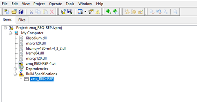

Hi Ning,
I am having the same error while creating executable. My OS Win-10 64 bit
Could share the dlls what exactly you included in your application.
 I tried to include following dlls.
Your answer would be greatly helpful
