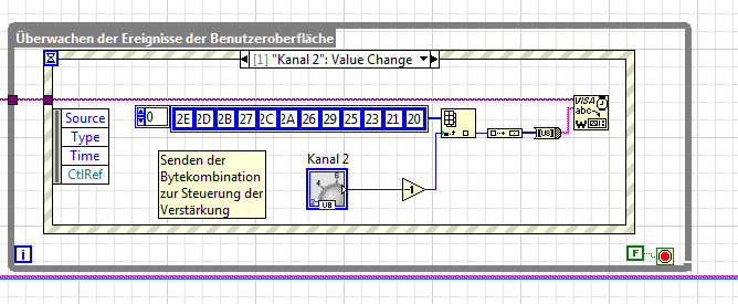

Something is blocking my loop and I can't update the buttons
Hi, programing in Labview is like jumping from one to another problem...:mansad:
This time I can't get why the main while loop isn't updated at all?!
Ok, there are events and also a case structure, but why isn't the program running at all?
The button (Abspielen) only works when I remove the event structure and the main program (inside of the case).

- Without being able to open your VI right now I guess your event structure blocks your UI. In each event configuration you have the (quick&dirty) option to unblock the UI while the event is processed…
- Don't hide event structures inside cases.
- Process events as fast as possible.
Mind to attach your VI in LV2011?

Steffen,
please go for a proper producer/consumer pattern and PLEASE make the diagram way smaller....

Hi Steffen,
as Norbert said: clean up, make the BD (way) smaller!
- In case of a VISA error your innermost VISARead-loop will spin forever, burning the CPU (and blocking your VI)…
- Do you really need a VISA-timeout of 4000s (or ~66min)?
- Please don't hide event structures inside case structures. They will prone to block your UI…
- Don't create several event structures within one VI. It may work, but it is not considered "good style"…
- Don't delete the label of controls or indicators. In text-based programming you wouldn't do this too. In case the label isn't needed on the FP you can always hide it!
- Don't use local variables, when the terminals aren't used so far…

your loop is not running at all because you have put one event structure inside while loop with no timeout case.
so only when you have an event fired that is registered with event structure then your loop will run once and again going to wait for an event to occur.

Along with some of the other problems pointed out above
look at this loop:
If the value of "Abspielen" is true this loop will start.  and never end.............................Blocking the outer loop from ever iterating again. (at least while "False" is not equal to "True"--  And that is always the case in every instance where I have tested it)

SteffenS wrote:
I put a event structure inside a case. It might be a mistake, but doesn't solve the problem.
The entire code architecture is very problematic.
  • The events for "kanal 2..4" and "schreibe protokoll" lock the front panel until the event completes. Since some the event structures are inside a case structure, it is possible that the event strcuture can never be reached by dataflow, locking the VI up forever. Remember, event structures queue up events even if they are not ready to execute due to dataflow constraints. Since this loop never stops, the outer loop can never iterate. All code parts need to complete before the loop can go to the next iteration.
  • Each event structure belongs in it's own independent while loop which has no data dfependency to other code (i.e. in cannot be in another loop or case structure. etc).
  • In the lower corner you have loops inside loops and the innermost loop can potentially never stop if a certain character is never received.
  • What's the point of all these decoration frames?
  • You need to recode this entire thing in one of the extablished desing patterns. Use a loop to handle UI interactions and parallel loops to handle independent other parts.
