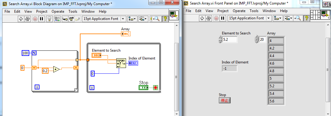

I just discovered a strange phenomenon of labVIEW, code as below:
When I search element as 5.2, 7.8, this Index will show -1 which means data not found. This is very strange because the data is just in the array.
Please help to know if there is some kind of bug of LabVIEW, thank you!

Not strange.  You are using floating point numbers.  It is highly likely that the two numbers are NOT actually equal.  Google "IEEE floating point numbers" so I don't have to type a few paragraphs explaining.  😉

This is NOT a bug!
Not all real numbers can be exactly represented in binary!  (IEEE 754 Standard)  There are only so many bits to try to represent real numbers in your computer that only knows how to interperet a bunch of 1's and 0's.  Comparing Floating point numbers is always a challenge.  you need to see if they are "Cose Enough" to equal.

Thanks, Jeff.
now I know that "the element to search" and the one in the "Array" are not exactly equal because they are all DBL format, is this right?
But how should I use the"Search 1D Array" function if my "1D Array" and "element" are all decimal
Looking forward to your reply.

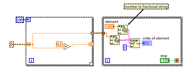

 Hello Daed,
Yes I guess you will have trouble with floating point numbers(dbl) like mentioned before, but one trick would be to convert to fractional string and then do search function.
Hope it works for you!
God Bless!!!
