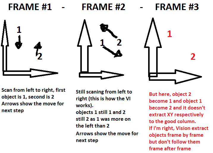

PS : Here is an explanation that might help you to understand why I encounter this problem.

Yes objects move, the XY I'm giving you are the XY coordinates every frame. In fact, these objects are insects.

Yeah, this is also one of my problem 😞 A huge one, I agree.
However, with a good threshold greyscale, we may avoid this because flies doesn't really use to climb on each other and doesn't stuck to each other.
In case it happens, I don't really know what to do. I posted on the Vision forum to have more informations about it; because I hoped that LabVIEW Vision was able to extract and follow objects, but I'm not sure anymore :S I don't think IMAQ Count Object can be set to remember objects frame after frame, unfortunatly 😕
