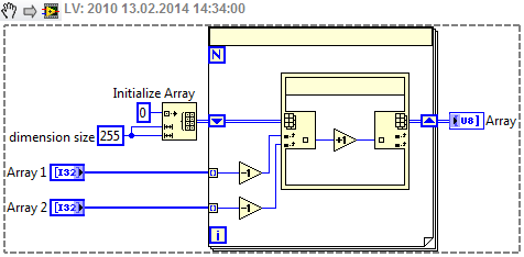

Or just do it this way
CLA CTAChampionI'm attending the GLA Summit!

Thanks for your help but maybe I do something wrong because Vi not working
Message 7 of 11
(7,229 Views)
You have not wired the array in to the place element structure. Its just wired through.
Subscribe to the Test Automation user group: UK Test Automation Group
Message 8 of 11
(7,227 Views)
Many Many thanks
