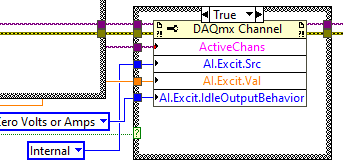

@JoePoerschke wrote:
The source for the Test Panels would be such a fantastic asset.  I see an IEPE checkbox on my test panel, translating this to "AIExcitationSource.Internal, 0.02" was not in any way clear.  The test panel for my 9234 also has MeasurementType of Voltage, but the only funtion that uses IEPE is CreateAccelerometerChannel, which would indicate G's were being returned and not voltage.
You can use the 9234 as a regular Analog Input channel which has the internal excitation. I do it all the time. Set up a task with Analog input then use a DAQ Channel Property node to set the excitation for EACH channel. You will need a For loop for this.
You can also use property nodes to see what excitation values are allowed.
