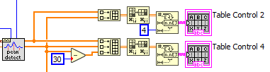

hai
I am bit new to LabVIEW and I am doing project  on generating report of founded peaks in the given report, So here I am finding difficulty while loading the different data array output to table so please help me in finding the solution for this any help will be greatly appreciated.

Hi kavyatweetee,
So you could take all those training resources offered in the header of the LabVIEW board!?
You have a 1D array of DBL values and you want to display them in a table, which is a 2D array of strings.
As has been said before you need to convert your values to strings using the StringConversion functions. I suggest to use NumberToFractString function…
(Or use a simple DBL array indicator: right click the output of the BuildArray node and select create->indicator.)
Edit:
In your image you already create a table ("Table Control 2"), but you fail in creating the content for "Table Control3"???

Hai Gerdw
Sir I tried "Number to fractional string conversion" and then to table but it shows error in wire and when i am using array it shows only first values of the "Build array" and actually i want the same data output that is given to the input of "Build array" with three different columns in table. So help me in finding the solution for this.

Hi kavyatweetee,
you just need to replicate the conversion as has been done for TableControl2.
I guess you are able to do so!

thank you sir,
This time i will attach my VI and sir i can easily load the output values of "peak detector" that is both amplitudes and locations to "table control 3" as i was previously done with "table control 2". But here i also want to load the values of amplitudes to table after subtracting it with 3. Basically i want the total output as in report format.

Hi kavyat,
I told you to replicate the existing code:
Just do that!

Hi GerdW
It is working.Thank you so much your help means a lot to me and sir another question if you don't mine I want to add serial number for that table and i will not Predefine those values and how can i add those numbers in increasing format is there any other option for that??????

Hi kavyat,
a table is just a 2D array of strings.
When you want to add elements to your table you need to use BuildArray to append/prepend elements to that array!
(Or use property nodes of the table to set column/row headers as needed.)
