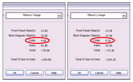

Here's a great way to demonstrate that the compiled code actually exists:
  • Create a runnable VI and save it.
  • Click Ctrl+i and go to Go to "VI Properties » Memory Usage".
  • Notice the four different parts mentioned above. Notice the size of the "Code".
  • Make the VI non-executable by breaking the code - e.g. delete a necessary wire. Save the VI.
  • Notice that the size of the "Code" now is practically 0 (most likely 0.2 KB) - this is because the VI couldn't be compiled and therefore no compiled code was saved.
I hope that this makes it easier to understand what goes on behind the scenes.
