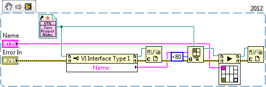

Chris,
     Here's how I do it.  The following code will work in both Development and Run Time environments.  The VI I'm trying to spawn is UTIL Save Project Name.  As you can see, I've built a Static VI Reference, browsed to this VI on my disk, and also checked the box to make it a Strictly Typed VI Reference.  I wire it to a Property Node and get its name, which I then wire to a Get VI Reference.  You might ask, why, if I start with a (Static) VI Reference, am I going to all this trouble to get a(nother) Reference?  Well, I have to set the Start Async options, in this case, "Call-and-Forget" (x80).  I also need to wire the (strict) VI Reference into the Type input of the Get VI Reference in order to get the required Strict VI Reference that the Start Asynchronous Call requires.
Try this, and let us know if this works for you.
Bob Schor

Hi Marco,
Thank you, this works (sort of). What I mean by that is calling *small* VIs does just what it should do. However, for larger VIs, a window opens up that shows LV finding and loading the various components, then it suddenly closes and reports Error 1003 (subVI is not executable). Yet, I can run it on my development machine. It does have OOP, and some of the non-referenced children can't run on Windows, so maybe that is causing a problem, even though it shouldn't. Do you think this might be what is happening? I suppose a work-around is tio put in a bunch of Conditional Disable structures, but I would prefer not having to do that.
Chris

Who's Marco?  Are you responding to my post?
When you get Error 1003, does it say what subVI is not executable?  Have you set any "Execution Properties" (like reentrancy) on any of your VIs?
I've used this technique to spawn 24 copies of a video capture routine, monitoring (and recording from) 24 cameras simultaneously.  Needless to say, there were a lot of VIs inside the single VI whose Static VI Reference I used ...
