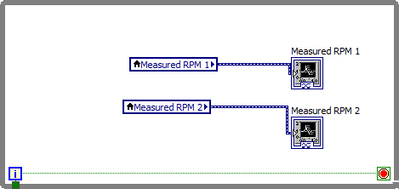

I only had time to look at the code briefly, and, well, in a word, YIKES!   For others reading this who *do* know LabVIEW, check out this little gem as an example:
Halloween's over so I won't share any other horrifying images, but suffice to say, this isn't code I would try to fix incrementally.  I'd call in the bulldozers, tear it down, and start over.  Sorry, I know that doesn't help you in the short term, but it's probably important for you to be aware that your end-result data is built on a pretty shaky-looking foundation.
About all I can think to recommend is to start very simply by working out the *algorithm* for TTS and TTZS in isolation from the rest of things.  Collect several files worth of representative raw tach data.  Then make code that can take this data and post-process it to calculate TTS and TTZS.  Expect to make several distinct versions of this post-processing code because some things you try won't work and you'll want to be able to revert back.
