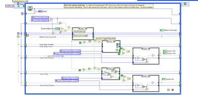

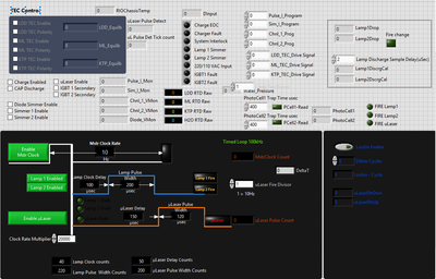

Ok, I dug the code up from my archives, here are some FP and FPGA Code Diagram screenshots. As you can see it was to provide timing/pulse control for a pulsed laser.Nova Laser Control Panel.png
[Above] RT Front Panel - which for R&D we ran the RT Front panel.

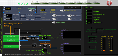

[Above] FPGA Front panel - same as RT - as we want to clearly communicate to the Laser R&D scientists what exactly is going on with the timing and pulse/timing settings. (They liked this GUI very much  - very clear to understand.
[Above] The FPGA Pulse Timing loop - this is where the timing settings were modified from the RT FP, notice - No FPGA I/O nodes here - they read the 'Lamp Fire' controls via the local variables in this loop.
Again: This was a recommended implementation from NI - which WORKED exceptionally well. As the conventional coding method - FPGA FP controls in the same loop as FPGA I/O calls - cause long observed latency...via a oscope on the laser pulse control lines.
