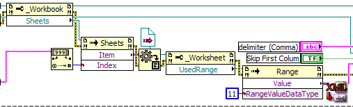

There is an option where you can read the entire contents of a sheet using XML inside Excel. It can come out in a few different XML foramts. You will have to convert the XML to string data or interger data but here is what we do.
19971i90A43B8BFDD27F80

aeastet,
Would that be faster? Could you perhaps post a VI or a snippet as I don't know how to replicate that code!
This is all active X. It would be very fast. This is how we read all of our Excel files. You can look through the Excel forum in the Breakpoint section the the forum. It will give you ideas on how to do this. Active X is complicated. I gave you the components to do what you need. Look at the Excel open examples that ship with LabVIEW and then you can plug the rest in.
