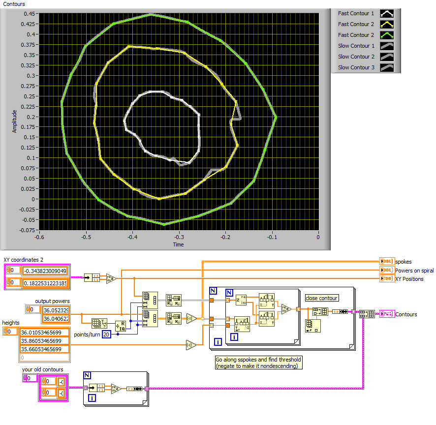

Are the xy points always on a spiral approximately centered on the minimum? As long as you work with the points you have, event f there are 3000, it will compute the contours in microseconds if done right. Do not generate gigantic amounts of fake data that needs to be reprocessed at great costs.
Here's a quick example with your 300 points assuming 20 points/turn. It would be easy to remap the data differently as the situation changes, but this should get you some ideas. For all practical purpose, it returns the same result (possibly with fewer artifacts :D)
See if this gives you some ideas.
Here's is the result compared to your result. (Colored are mine, Grey are yours)
Message 7 of 17

DO NOT EVER ATTACH A MODIFIED COPY OF MY OWN VI AND GIVE IT THE SAME FILE NAME. THAT IS VERY DISRESPECTFUL! If it is a different file, it needs a new name!
(Now your data is no longer an inward spiral, so you would need to change a few things. See how far you get.)
Message 9 of 17
(5,428 Views)
Sorry for that really, I didn’t  know about that before.
Regarding the code, I thought the problem is not only with the spiral, because if you change the points / turn in your code you would see sometimes messy contours.
Its amazing how fast can plot the contours comparing to my old code but I trying to understand how can I make it valid for every type and number of data.
This would change alot in my system.
