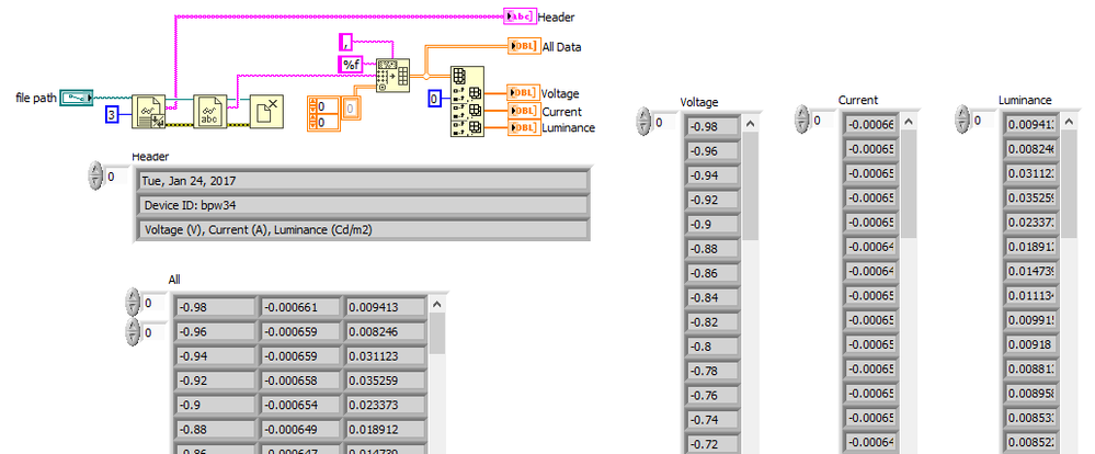

OK, I finally look at your VI.
Why is there a while loop that re-reads the same file over and over as fast as the computer allows? This file only needs to be read once (or whenever it's contents change) and not millions of times a second!
By now you probably figured it all out, so here's how it could look like if you first want to read the three header lines.

Ok so I finally made this work after I changed the array type to 2D, rebuilt and wired everything and also removed the delete array function from after the first 2D array to after each 1D array and it worked. I have no idea why but I'm glad that it worked. The errors are because I didn't take the screenshot of the whole section of my program.

Still looks extremely convoluted. "index array" is resizeable and if you delete the first  3 rows first you don't need all these "delete from array". Did you even look at our suggestions?
