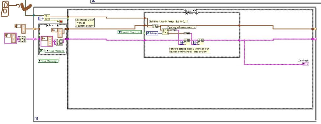

Old program:
In the old program we measured with a Keithley 2600B which has channel A only.
At the beginning you enter start/end voltage and the number of steps. The program goes in a loop through the voltages and measures the current (transform into current density).The data is sent into a queue in the loop you see in the - (this loop is only for inserting the data into a coordinate system in parallel during the measurement):
On the far left, the array is initialized once. The first True/False is only activated if there is a new measurement there everything is set to 0 again. If it is false, the line simply goes through and collects the measured values that arrive at the top in a loop.
In the second box, the measured [voltage, current] number goes into an array of 2, so an array is built from pairs of numbers that becomes longer and longer. Theoretically you would know the length because if you divide start/end by the number of steps you get the number of measurement points, which is also stored as a global variable (Points).

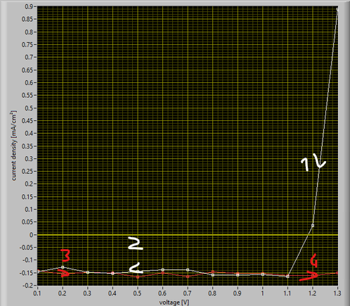

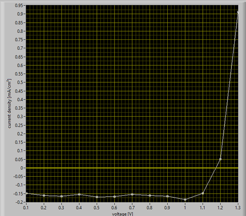

For a measurement from start to end, for example, it starts at 1.3 V, ends at 0.1V with Stepsize 0.1 the point number is 13 (i.e. the measurement points).
At Start to Start it starts like the other one first from 1.3V to 0.1 after the Point number is exceeded, the array is divided and is entered (in red) from 0.1 to 1.3, in total twice as many measuring points as in the first case.
At Start to Start it starts as in the other case from 1.3V to 0.1 after the Point number is exceeded, the array is divided and is entered (in red) from 0.1 to 1.3, in total twice as many measuring points as in the first case. The array is divided by a Split 1 D array block at the Point position.
Points is only as big as the white lines measurement therefore it is 13 and the Split is at 13/26.
So that's it for the old stand! This all works and is a fine thing. And this is how it should work with the new version

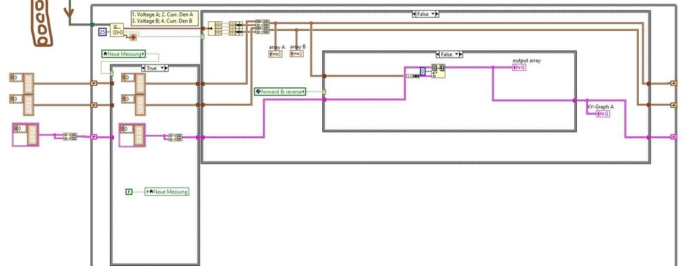

New Version:
1st PROBLEM:
In the new program, a Keithley 2614B is used to measure, which has channel A & B.
At the beginning you enter start/end voltage and the number of steps for channel A and B. The measuring program then goes through a double loop in the outer loop, channel B is always increased by 1 step when channel A in the inner loop has measured once completely. Then channel B one step further and channel A measures everything again and so on until channel B is finished. Instead of 2 values, there are now 4 values passed: 1. voltage A, 2. current A, 3. voltage B, 4. current B

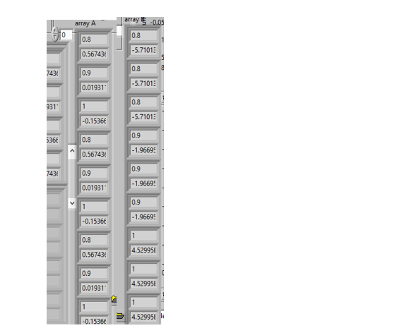

So the arrays would look like this when I look at the Array Values A and B:
So as I said while array A goes from 0.8 to 1 in 0.1 steps array B stays constant at 0.8 then array B goes to 0.9 and array A goes through the 3 steps again.
The measurement data are not correct now of course, because no sample is connected but the principle behind it is the same😎
If you look at the loop you see that I first divide the data of A and B and make them into 2 separate arrays, because at the end channel A and B will be plotted in two different graphs.
In the - you see again the same as in the previous program the whole initialization stuff on the left side.
I see there is still a pink line missing for the channel B, since I do everything piece by piece I start first with channel A (therefore channel B is missing).
Back to the Problem:)
Unfortunately I can't manage to split the measurement in a meaningful way.
Example I have 3 measuring points at A and 3 at B means channel A measurement is executed 3 times so 9 measuring points but form Start to Start means a total of 18 measuring points (the voltage steps):
Array B: 1 1 1 | 1 1 1 | 2 2 2 | 2 2 2 | 3 3 3 | 3 3 3
Array A: 1 2 3 | 3 2 1 | 1 2 3 | 3 2 1 | 1 2 3 | 3 2 1
(actually every value has a current value which belongs to it but I left that out here for a short time, for overview reasons).
I just can't find a solution how to split the arrays internally again? Probably somehow through a loop, but I'm really biting my teeth
The normal block 1 D array split just doesn't do it, because that can only divide once to a certain number value and if I divide to the points value I would have only 2 arrays. I needed a function that splits an array with n elements regularly at position n (n multiples). So in the case from above at every 3rd place. That would be already a huge step.

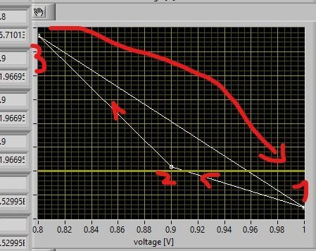

If I just plot it from 1 to 0.8, it jumps also jumps from 0.8 to 1, which is logical because the system thinks that the array continues. Here also the question how do I get it that at the point n I divide the array each time so that the line from point 3 to 1 disappears therefore it always just does 1 2 3 and then does 1 2 3 again and considers it each time as a separate line. I hope it is clear what I mean
Later when tandem solar cells are connected the lines will not overlap like now. So it would be nice if the line from 3 to 1 is not there anymore. Also because then measurements are made with 1000+ points, so it would be a mess haha
I would be happy about your solution suggestions 😀 I will continue to try myself. Maybe with loops to split the whole array. Let's see what I find while trying around:)    

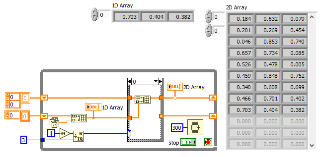

I am not sure about some of the terms you use (e.g. "separation") but basically you need a 1D array of your data structure and a 2D array with three columns where a new row is added whenever the 1D array is full.
Here's a very quick draft that could possibly give you some ideas.
(On a side note: To get help, attaching VIs is recommended. Nobody has time and desire to study a huge collection of static images)

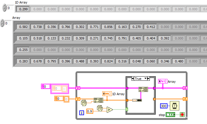

LabVIEW does not have "ragged" 2D arrays, i.e. all rows must be the sane size. However you can do a 1D array of clusters, where each cluster contains a 1D array of data. Now each inner 1D array can be of different length, or even empty.
Here's one possibility:
Message 4 of 27
(3,217 Views)
And here's how you could update the data structure live.
Message 5 of 27
(3,212 Views)

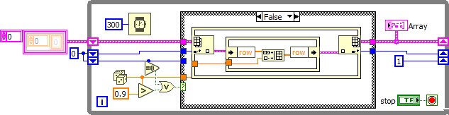

Sorry, I won't be able to look at your code until I am a computer with a larger monitor. (currently on a small laptop).
OK, so a 2D array is correct, you just need to decide on the number of columns before you start building.
If you want to build the rows up as you go, you need to create an entire new row filled with NaN, then replace each point as data comes in. (NaN values will not show on graphs).

Here's the NaN idea for plots with incomplete data mentioned earlier.
(I change the points style for each plot because using the default style you cannot see the first point. There are some other subtleties, e.g. we need to ensure that the plot actually exists before we set the active plot)
Message 9 of 27
