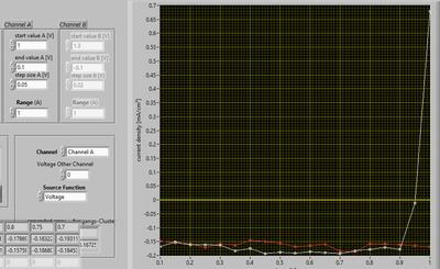

haha it tried it out by just adding one more, but i think i did the array wrong because the output is realy weird 😄
Actually  the x values are spaced equally, because  I give the Keithley a voltage range (for example 0.5 - 2) and a stepsize like every 0.1 measure the current density
. And the Current density is randome 🙂
EDIT: i didnt saw your new message i will have a look:)

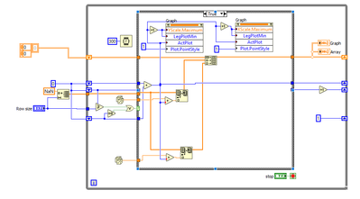

Something like this
on the left side i enter the Values, the count of the Number from end to Start is calculated in the beginning and stored in a global variable (points)
I changed the file name:)
Yes, you really got some wires crossed. Here's a quick correction that seems to work better.
If you add two rows, the row index needs to jump by two. Your IPE has the same indices wired to both new elements. etc.
