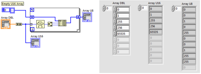

This may be what you are looking for. Start with Array DBL, convert to Array U16, pass array into For Loop
For each U16, swap bytes, Split Number into two U16 bytes, build array from the bytes.
Front Panel with test numbers shown with some test values.
Note on previous post, beware of Type casting DBL to U16, it does not give the results you expect, the Convert function does.

@SteveE: Thanks for the reponse! One thing I noticed is that it coerces my lo and hi values when implementing this. Is the empty array initialising the shift register supposed to be an empty U8 array?
