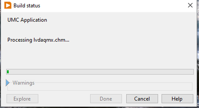

Darren,

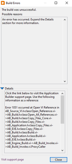

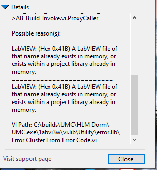

The bug is definitely not fixed, or there is a different one remaining.  I upgraded to LV 2025 Q1 and have the same problem.  When I press BUILD, it takes an unusually long time to start doing anything.  When the build status window finally appears, it gets stuck on this view for a very long time (>10 minutes)
Then eventually, I get a pop-up saying the build failed:
Error Cluster From Error Code.vi is a built-in VI that shouldn't have any issues.  It appears in my dependencies, but I can't find any other instance of it in my project.
