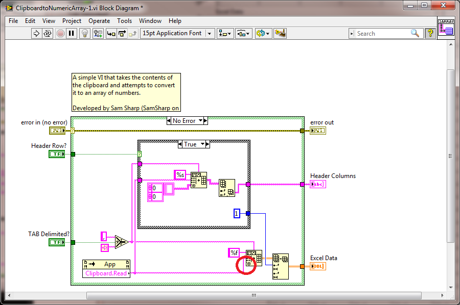

I up loaded the CSV file and program that I used. Please find the attached Figure 14 that displays my copy to clipboard from the CSV file and Figure 13 that displays what the "ClipboardtoNumericArray.vi" captured. Assuming zero for the first column or row, look at column-5 and row-0 through row-5 in Figure 14 and Figure 13. The element source is negative and the result is zero. Why?

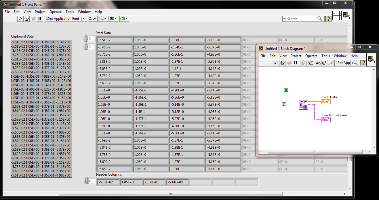

Everything looks fine to me, must be something else in your software causing the issue- see attached file. (I used excel to try this out - I formatted some data as text and right justified, but it still gave me correct result - so that doesn't seem to be the case here. In fact in excel I also made some values as text and left others as numbers and I still got correct result.. second image/column 0/values in rows 2 and 3 are text.)

The problem is that your negative sign is not a negative sign.  It is ASCII code 150.  I'll call it something like a "long dash", which is why the LabVIEW code doesn't recognize it.  A real negative sign like you have in the E-6 part is ASCII code 45.  And also why even Excel treats it as text rather than a number.
