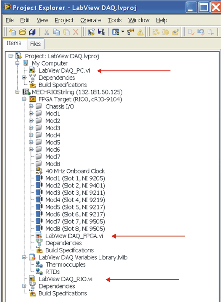

Thank you very much for your reply. To answer your question, I'd say the latter. To be on the safe side, though, I'd like to describe my setup in my own words: The executable (basically a data acquistion programme to read in sensor data) that I'd like to create is going to run on a laptop with only the NI Runtime engine installed. The laptop is connected via ethernet to a CompactRIO which, in turn, communicates with the FPGA that my sensors are connected to via the modules. I've created three VIs (PC level, CompactRIO, and FPGA) in LabView - see Figure. I hope this makes sense.

1. Did I make a mistake when building my application (executable) by specifying wrong directories? For example, should libraries be included in the *.rtexe or 'same as caller' or support directory?
I didn't see an executable in your project, neither at the Windows site nor at the realtime site. When creating an executable there are some things to consider, like the appearence, how you stop it (exit), path's and for sure dependencies like dynamic called VIs or other files. If you don't have dynamic files to load, there is nothing special to include.

I probably took the screenshot before I built my applications. I definitely have created an application on PC level and one for the CompactRIO.
