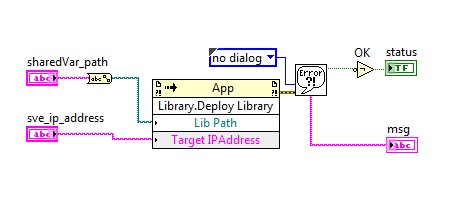

export a function to load a Library from a different path to the SVE (with the specified TargetIP i.e. localhost)
