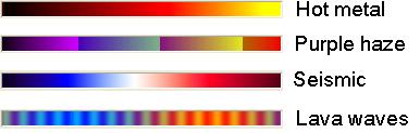

Hi all,
I am trying to change the color table of an intensity graph to some standard color tables, such as "rainbow", "gray-scale", "seismic", "lava waves", "hot metal", "purple haze" , etc. I can find "rainbow" and "gray-scale" somewhere from the examples, but not the others. I tried to generate those color tables myself using the example "...examples\general\graphs\intgraph.llb\Create IntGraph Color Table.vi, but the result was far from good.
Anyone can teach me how to generate those color tables? Thank you in advance.

Hi GerdW,
Thanks for your ideas. I tried your second idea, it works for simple color tables such as the "seismic" and "hot metal". However, for those complex one such as "lava waves", it will be really headache. Is there a simpler method such as import from a picture?

Hi GerdW,
I am not sure the exact way of doing it, but I made a simple vi based on your idea. The vi can extract the color table I want in array format, provided that I load the bitmap file containing only the color scale. Some color table array constants are included in the VI for those who need them. Please see the attachments and give me your comment.
