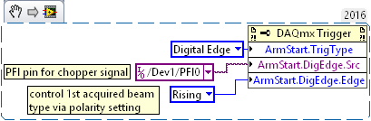

I think the most straightforward way to do that is to add an Arm Start trigger to the Ctr0 task.  It'll continue to use the ChangeDetect event as a retriggerable start trigger.  But the Arm Start will be a one-time-only way to control the initial polarity and thus select which beam type is acquired first.  (You may need to parallel wire the chopper signal to both digital port 0 *and* a PFI pin to make this work.)

Please find in the attachments my last version of the software with a snippet of the interested state.
I have the two branches, alternated by a chopper, and I want the chopper and the acquisition to be synchronized so that when I acquire, the first image always corresponds to one of the two paths (doesn't matter which one of the two).
I made a try with the property node "arm start trigger", as you suggested.
The try was that of starting several acquisitions with one of the branches stopped after the chopper by a shutter, so that ideally, over let's say 100 measurements, all of them would have started with the same first image (coming from the non stopped beam), and then a dark image (dark because the beam was stopped before shining the sample). What I measured is that over 100 measurements, almost 90 start with the ON image, while the other 10 images start with an OFF acquisition (like if they were triggered by the falling edge of the chopper TTL).
What I want is the first image to correspond always to the same branch, i.e. always to the rising (or falling) edge of the TTL output by the chooper.

The task start sequencing looks ok for all the counter and digital tasks.  I think you should probably be starting your AI task *before* DigitalCounter Task though.
I would say that NO, it isn't possible that the correct behavior of the Arm.Start node is influenced by the chopper frequency.   I'd say the reason it kinda *looks* that way almost certainly has to do with my second point about all the parameters that control pulse timing.
You have a chopper wheel in motion.  From the moment you start the DigitalCounter Task, the very next chopper wheel *edge* of the chosen Arm Start polarity will arm Ctr0 and let it start doing its job of retriggered pulse generation.  The regular Start Trigger will register almost immediately (because the same chopper wheel edge caused a ChangeDetectionEvent that's used as the start trigger) and Ctr0 will begin its job of pulse generation.  In addition to the high time and low time you've wired, it's also crucial that you understand how the 'initial delay' value will be used for your particular device.  (It has varied over the years with different devices and driver versions.  Best to look it up then test & verify.)
Anyway, you're kinda setting up a race.  The time delay from the triggering edge until the chopper changes state again depends on the chopper speed.  Meanwhile, your pulse parameters control the delay from the triggering edge to the frame grab.  Further, I see that some of your pulse params depend on the estimated chopper speed while others depend on user input.  And the 'initial delay' parameter is left unwired so your code has no effect on it and you'll get some default behavior you'll need to investigate.
