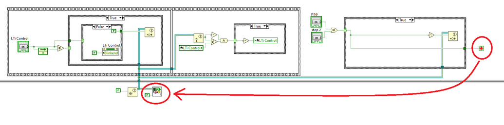

Hi Ralf,
@Eisbein wrote:
When stopping the main loop (Stop button) closing the vi takes forever. It seems that, although I can't see any reason, the lower loop runs into a timeout or anything else.
Because you are doing all this much too complicated!
And you don't stop the subVI when you press the stopp button in your mainVI! You just close the frontpanel, which will not stop execution of the subVI…
Just cleaning up your VIs:
Notice the subtle changes I made! (No shift registers in the subVI, feedback nodes in the mainVI, small wait in the lower loop,…)
I recommend to use just one (1) queue to send commands from main to subVI: why do you need 3 boolean notifiers when you can do all this using just one queue sending a typedefined enum command?
Btw.
  • using buttons with mechanical switching behaviour is rather uncommon for UI, especially on stopp buttons. You really should use latching buttons and an event structure to determine user actions. No need for those feedback nodes…
  • You forgot to cleanup all those references in your VI. Where do you place the ReleaseNotifier functions?
