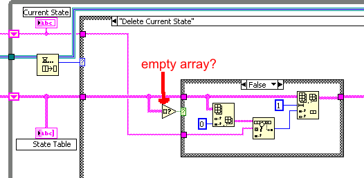

@labVexpert2b wrote:
I also figured out that I can use the Re-initialize to Default InvokeNode and confirm with data flow.
Hence, I don't need to use LocalVariable to set the Ring control to the default Value.
Is this an efficient or good practise?
I am pretty sure that the property node call is much less efficient. I would stay with the local varaible.
Here's another comment: In the "delete current state" case, you slice out column 0, then see if its size is zero. Instead, I would check if the 2D array is empty (there is a tool for that!), and only slize out the column if you need it.
