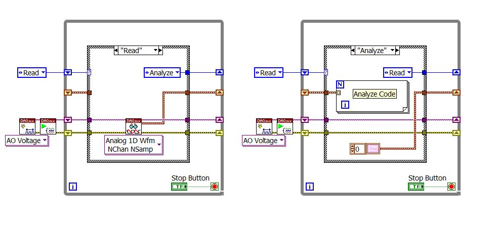

State machine with array

Maybe the following is what he was trying to explain.  A state machine that goes from read to analyze?

yes, but for this you do not need a state machine. Just do a read, and analyze it in the while loop. Of course the story is different if the system needs to move to different states. But here we have only one condition: numbers are in range? If yes, go on with your while loop, if not, either you can stop your loop or give warning toward the user. Just use a simple pop-up window for this, the user can decide... KISS principle 🙂
edit: I guess you put AO DAQmx by mistake in your example, we deal here with AI
