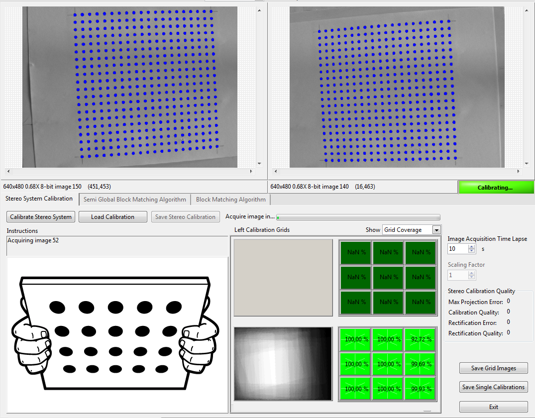

I'm using the Calibrate stereo vision.vi (NI Vision development module 2013) to calibrate my stereo vision system but I failed and I don't know why. My experimental setup is as follows:
2 aviator 1600gc cameras, with 16mm focal lenses and a baseline of 1 cm;
a calibration grid of 16*16 dots (dx=dy=4 cm), at a distance of 2 meters;
2 light projector of 500 W.
I followed the VI instructions and made a lot of trials for 2 days, but i never succedeed in calibration. More specific, in the grid coverage control i always obtain NaN %, as showed in the picture in the attachment.
In continued to acquire images as long as all gride coverage control below are all to 100% but the VI doesn't proceed into grid vertex calibration.
Can someone help me?

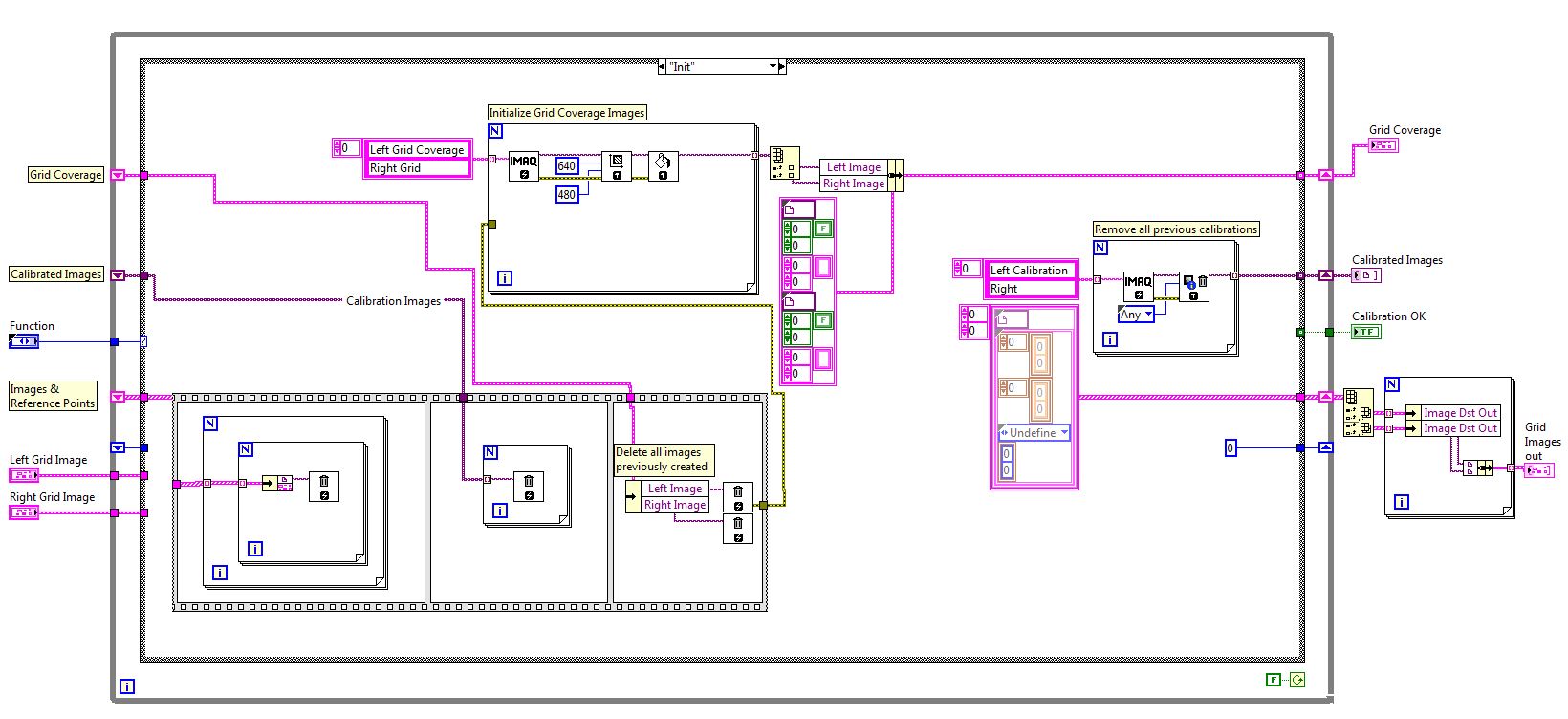

I manged to solve it:
Searching for the timing problem, it led me to the Calibration Manager (Init Case):
reprogramming the case as following solved the issue:
(6,038 Views)
