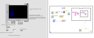

Kind of new to labview. Please see attached photos:
I want to stop the program, after i have pressed "Ja" on my two button dialog, and show the text "HA DET BRA" as shown in the case structure.
I have tried this
But it doesn't work.
Could anyone help me?

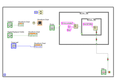

Hi mo,
@mo14 wrote:
 I have tried this
Did you read the errors when you try to run your VI?
You cannot connect two data sources by wire (button and Dialog function): when you want to stop the VI after dialog OR stop button then you should use an OR function...
You also should learn about using tunnels: they require a data value when not set to "default if unwired"!

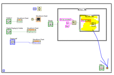

Use the "or" function. If you press stop or display your HA DET BRA dialog, stop the loop.

Hello!
It worked:)
Was it like this you meant?
(2,548 Views)
@mo14 wrote:
Hello!
It worked:)
Yes, that should work. Do you understand why? If you activate the Light bulb and run it in highlight mode you'll get more info as to how/why.

I think so,
When "Ønske button" is false, the false case structure is activated, the OR function gets 2 false, so the stop loop wont be active.
If i press the button, the TRUE case structure gets active-> the pop up dialoge comes up, if i press "JA", the two button dialog gets an active output.
This means the True case with the two button dialog becomes active, AND the OR will be active from this. So the program stops.
Can you explain in more detail if I've missed something?
