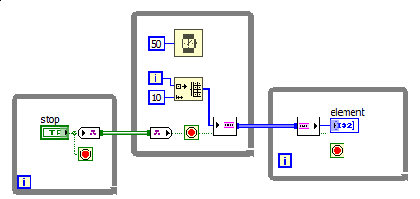

I am trying to do something like what's shown in the attached snippet, but the stop button doesn't work. It does when I use property nodes for the data channel, but for code readability I'd much rather use the channel.
The 50ms wait is, sadly, required, since I think that's where the problems lie (it certainly works without it). Any ideas?

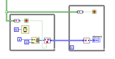

The Tag setup will effectively signal all of the loops to stop running, but you still have an active Stream Channel.  Fix this by wiring the output of the Tag Channel (that becomes True to stop) to the "Last Element?" input of the Stream to also stop the Stream Channel (that's why it is there!).

And a third easy solution, haven't thought about that, so I made a quick screenshot:

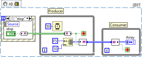

Not only is Jens' solution "easy", it is "better" than my original (correct) Solution.  Here's why (and a final example to illustrate the point):
  • You have two loops in a Producer/Consumer Design Pattern.  The correct way to stop such a pair is for the Producer to get a signal ("Time to Stop"), to stop, and then to tell the Consumer to stop.  This way, you can't have "orphan data" in the Producer-to-Consumer pipeline.
  • Until Channel Wires were invented, this was neither obvious nor emphasized (I only started yelling about it a few years ago, myself).  But Channel Wires, particularly the Stream Channel (used for P/C Streams, after all) include both "Last Element?" and (if you only want to stop both loops but not send data), "Valid Data?".
  • If all you want to do is have a Stop that fires once and then stops, an easy way to do with, without a loop, is to put it in an Event Structure.
  • The Tag stops only the Producer.  The Producer then stops the Consumer.Tag Stop Producer-ConsumerTag Stop Producer-Consumer
