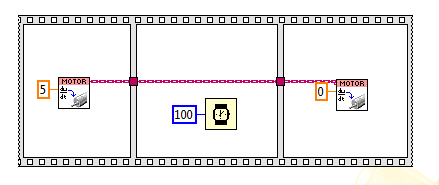

Well, we are using two andymark motors with gearboxes on them to lift a mechanism on our robot. But we wanted to know how we could place a code in labview that won't allow our motors to go up anymore after a few seconds or go down anymore after a few seconds. This is done to limit the movement of the mechanism so it doesn’t break. Any ideas?

    If you have an encoder for the motor, you can measure the position of your motor angle and stop the motor once it reaches the position. If you don't you have to drive the motor and stop it after a time delay using the time delay functions in LabVIEW.

For example, you can set motor speed and wait for 100ms and set 0 speed then. Adjust the time delay by experience.
