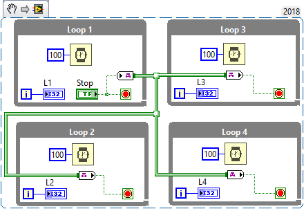

I was going to demonstrate stopping two loops using a Tag Channel Wire, but got carried away and added two more loops (and could just keep adding them ...).  Here are four loops, running in parallel and being stopped by a single Stop button in Loop 1, using Tag Channel Wires to carry the Stop to the other three loops.
This Snippet is in LabVIEW 2018, but if you have LabVIEW 2016 or 2017, it is very easy (and very educational!) to create.  I recommend making Loop 1 without the Stop Control (or Channel Writer), duplicate it to make the other three Loops (arrange as you wish -- I tend to arrange parallel loops vertically and "snake" the Channel Wire "out the right", loop back, and "in on the left", but a horizontal arrangement (as in Loops 3 and 4) is also common.  Anyway, create the Stop Indicator, the Channel Writer, the Tag Channel Wire from Loop 1 to Loops 2, 3, and 4, and finally the three Channel Readers.  Be sure to choose the Tag Channel when you create the Writer.  Note that the Channel Wire is a nice shade of Boolean Green.

I wish I was, because your solution seems very effective and logical.  However, the version I am using is 2014.

Well, if a Tag Channel is a Notifier on Steroids, you could do it that way ...  If you do, be sure you use Wait on Notification and set the TimeOut to 0 (so, paradoxically, it doesn't Wait).
