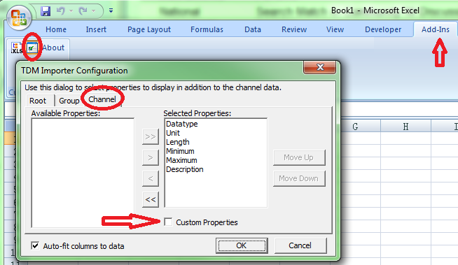

yep the idea is to open it in Exel.
could you tell me better where I can find these custom properties? because I haven't seen them.
Thank you
(3,777 Views)
Accepted by topic author inuyasha84
Sorry I forgot to attach the screenshot...
(3,773 Views)
Great!thank you very muchSmiley Happy
