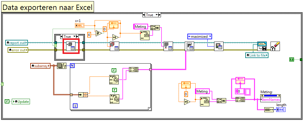

I write to the excel file with the next code:

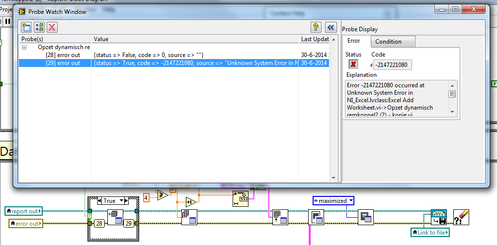

The functionblock inside the red square is giving the next error (after I try to write new data to the Excel file when I already read it):
As you can see the error is occuring in the VI because it's not present at probe 28. For reading the excel file I use the 'Excel Get Worksheet' and 'Excel Get Data' VI's also from the Report Generation Toolkit.

At first sight nothing seems to be wrong in the displayed code. The error might be cause by something happening before this code section is executed (like if the report is closed). You said you are reading the Excel file but this part is not shown in your picture. Since you are using local variable to pass the report object a race condition may also be possible.
Ben64
(3,391 Views)
When I put the reading code inside the same loop to pass the local variable everything works just fine.. I should've thought of that, thanks!
