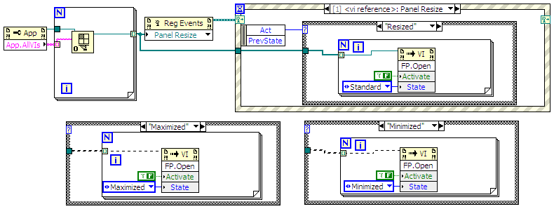

I have a situation where, when I minimize one certain LabVIEW VI window, all open LabVIEW VI floating windows need to be hidden or minimized.  And conversely, when one window is 'restored', the others are also restored to their original panel dimensions. Oh yeah, and that one certain window always has to stay bottommost or in back of the other LabVIEW VI windows while all the windows are restored.
The strategy I have tried is shown on the attached graphic, at least for the minimize part of the problem. It uses the winutil32.llb VIs for windows management. The minimize fx don't seem to work for me, nor does the hide window fx.  (I allow the user to minimize windows (in VI Properties, Window Appearance).)

Hi Don,
this code should help, maybe you need to change the order of the VI array.

I will give this a shot.  In the meantime, prior to seeing your reply, I realized that the panel bounds comparision to trigger minimization of all open windows was not going to work (and I did not set it up right as it was), so I tried using the activity terminal on the left which gives 'minimized' as one of its choices and therefore should have been perfect for triggering windows minimization of all open windows.  Additionally and most importantly, the VI names are not the same as the window titles so the winutil32 VIs could not find the window ID.  So the attached code provides a good way to do this, except for the fact that I don't think I have licked the problem of always keeping the one window bottommost.  One of the winutil fxs allows you to 'Move Window to Bottom' which could be done at strategic times to possibly accomplish this.  But there seems to be now way to make window always bottommost within the LabVIEW application (whereas there is a VI to make the window always topmost).
What do you think about this code (graphic attached)?  Would seem to be an efficient way to do the job.

Ok, I took the gist of your idea and implemented it, except I did not need the additional event structure.  In my code, the event structure case 'Panel Resize' is triggered when the background panel window is minimized which then triggers the minimization of the other windows. Also, I only gather the VI refnums for those that have open panels (maybe you meant this but your screenshots appear to want to register all VIs whether front panel is open or not). It seems to work fine.  I never would have known about the front panel invoke node exposing the states, and I like your solution as it requires that I only need one of the winutil32 functions (that for moving window to bottom).

One thing you don't need the minimized comparison, just feed the ACT into the select case.

Good point on the ACT terminal.  Perhaps then a more compact form of the code overall looks like the attached.
