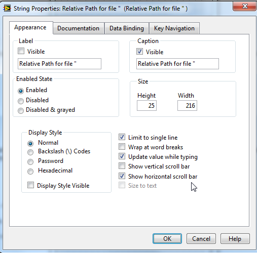

You've discovered a strange behavior of the String control.  Apparently you can't have it configured to limit to a single line and to show the horizontal scroll bar.  Turn of the scroll bar and Bob will be your uncle.
Jim
