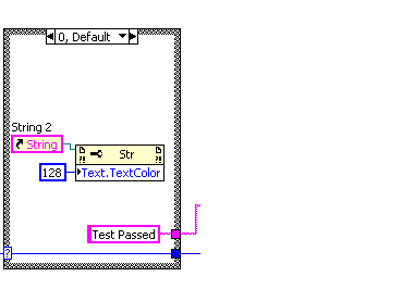

mmm I tried in this way:
128 should be green.... but doesn't work
Why? Green is 065280. It is easier of you set the display format to hexadecimal. Green is 00FF00.
Still, using a colorbox constant is much easier to use. It can be found in the "graphics&sound...picture functions" palette.
(See also this old idea)
