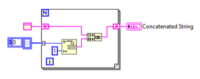

Your For-Loop is wrong. Try doing it like this instead:

Hi Dobrinov,
What's the point of a FOR loop at all in this example?
Why not go without a loop?

@GerdW wrote:
Hi Dobrinov,
I modified the loop he already had in place - much easier for him to figure out what to change to make it work. That and I'm lazy, so less effort for me.

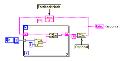

Thanks for your reply ,
I modified as per your comment , but i wanted to display the response continuously , because to keep the track of previous response .plesae guide me ...
thanks ..
If I even understand your request correctly then try this:

Hello Dobrinov,
Thank you very much for your time and support .
it is working properly .

Hi Anil,
I don't think so…
  • There's a small while loop at the left border set to iterate just once: why do you need a loop then?
  • The inner while loop with your CANRead code is set to iterate forever: how will you stop your VI gracefully?
  • There is an outer while loop with a stop button: why do you need this loop when the code within the loop will NEVER return?
You surely need to improve your VI…
