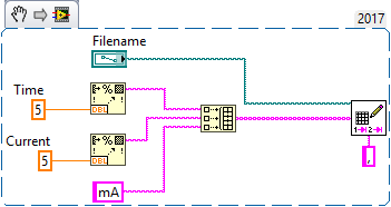

I would like to save a string into the first column of an excel sheet.
How can I convert the string in to dynamic data?(attachement)

I think the only way to do this may be to use the Write Delimited Spreadsheet VI.
Set the delimiter to a comma and use a .csv file extension which should open in Excel by default. Convert both the time and current to strings and then merge them into an array.

Thanks for your answers!
I tried your solution but couldn`t open the file as an Excel.
I am now working with the Set Dynamic Attributes and set the unit as an header of the file.

You need to make sure that the file is saved as "filename.csv" to open it in Excel.
Yes I looked at the atrributes idea but the Units parameters doesn't appear to be available within the excel file. Let me know if you find a way ! Smiley Happy
