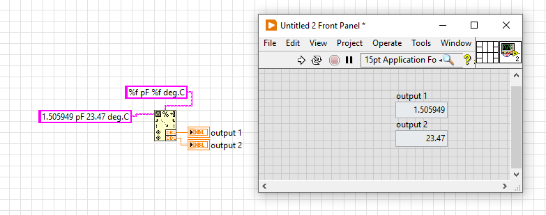

Also try this for parsing your string
EDIT: Fixed output1 display format so it was not rounding

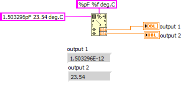

If you want to include the "pico" part to read the value in whole F units, there cannot be any space between the number and the p. After eliminating the space in some other way,  you could use %pf as scan format to get ~1.5e-12 for the first number.

Obviously I would call Output 1 Farads and display in SI units e.g. 1.23456p or 21.0987u
