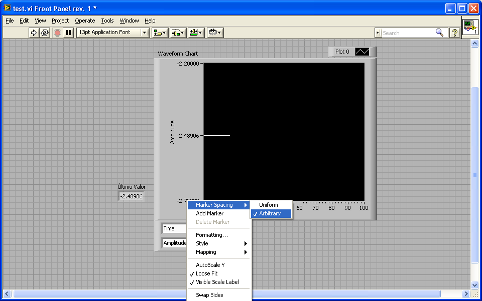

Those are the markers- since they are set to uniform spacing and autoscale is enabled they will be in = increments.
there are a few limits on marker formating. (Exactly 6)
As you can see the marker spacing is always the least number of sig digits that make sense- they are gridlines.  but! you can type any value into a top- bottom ar arbitrary marker and LabVIEW will use that value.
  Here I used an arbitrary marker and set it to numerics value
