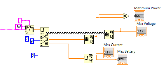

I have since taken the string and converted using "Spreadsheet string to array function" followed by the "index array" function which i can select the correct "elements" to recieve the values i am looking for.
The problem is now when i input this into an xy graph the x axis "iterations" seems good and flows at the expected rate yet when i input the y data converted to "dynamic data" i see nothing.  As if it is reading the single value each time?

You don't show us anything about your arrays and your graphing routine, but it does sound like your string parsing works. In order for anyone to help at all (although AKA_TG actually told you just how to do it), it looks like you're going to have to post your VI containing typical arrays of X and Y that you want to graph.

I just saw the VI that you posted earlier this week in another thread. It immediately answers your question here - your X axis has only one point, not an array. But you've got bigger fish to fry. Again, looking at your posted VI, yours is an awfully big project for a beginner to try, especially if you haven't had any LabVIEW training.
