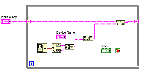

That's probably your best bet, although rather than use Spreadsheet String to Array (which would require you to delimit your data), you can just build them into a 2D Array and display that as a table or array.  Granted, this method uses two Build Arrays, one of which could grow infinitely, but I would hope you don't have hundreds of thousands of failuresSmiley Wink.
