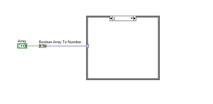

Structure CASE: Can I use a word of bit to choose a particular case?
I know that I can use "CASE STRUCTURE" in which I can set 2 different situation: TRUE AND FALSE. I know that I can also add other case, but... how can I change boolean value. I know that I can use also integer numbers, but... it's possible to use boolean words? For example save in an array 3 bolean value and if:
CASE 1: 000
CASE 2: 001
CASE 3: 010
ecc. ecc.  It's possible? Can you show with a VI (I have LV8)?

Hi there,
Why not use Boolean array to number?

VERY GOOD!!! It's automatic if I connect a word of integer that case structure change TRUE AND FALSE in numbers?
(3,124 Views)
Yes.

Yes, the naming of the cases is based on the data-type of the selector. For more info see this page at the LabVIEW wiki.
If you use a numeric, it's even possible to show the value as a series of bits:
