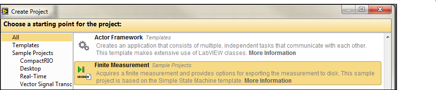

@Roryriffic wrote:
Hey Carlr,
Your application sounds like it would be best suited for a state machine.  Have you used this architecture before? If you click File > New... in LV then you can see what I mean from an example template --> select the Design Pattern for Standard State Machine.
Or, even better. File>>Create Project
Clicking the More Information bold text should bring you HERE
Message 5 of 14
(4,923 Views)
Hi Jeff,
Carl uses LV2010 and the links to "HERE" is located on your local harddisk...
Message 6 of 14

(4,913 Views)
WHOOPS, thanks Gerd
HERE
is the online version
Message 8 of 14
(4,901 Views)
... which gets me thinking Carl will need these VIs in 2010 as well...
