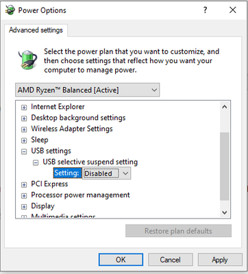

Your USB Power Option should be something like this.
I don't know what D0 and D2 is.
