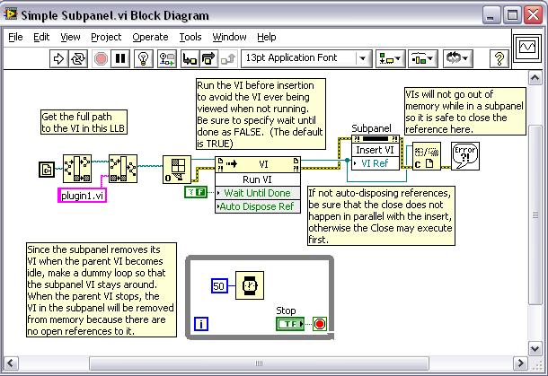

there is a simple subpanel.vi example you can take a look at.
its in the examples.

When I run the simple subpanel vi I see the graph but when I build the simple subpanel vi the application created does not show the graph.  How do I build it to include the subvi?
